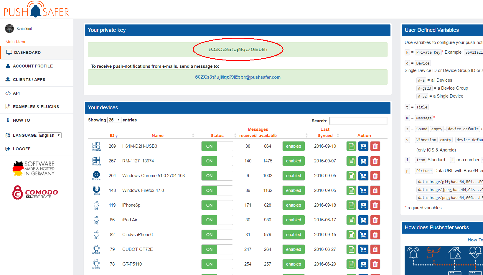

First of all it is required an account on pushsafer with a private key, instead of the private key, you also can use a alias key with predefined parameters. Pushsafer configuration
