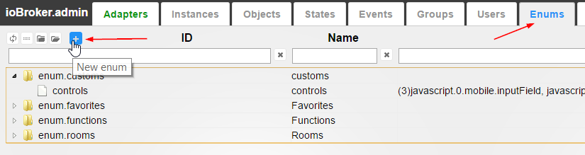

To use mobile UI you need to create the logical structure in admin.
E.g.: Go to the tab "Enums" and create new enum, e.g. "customs". Slider

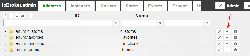

Create new enum group in "enum.customs", e.g. "controls" Slider

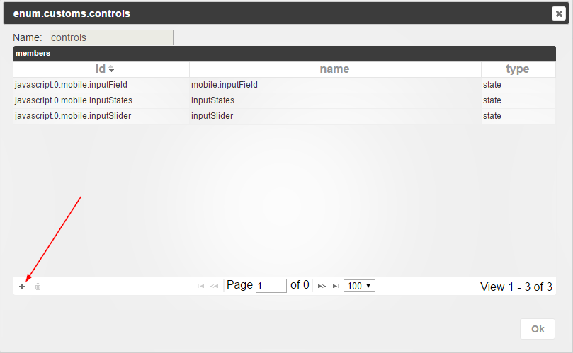

Add some states to "enum.customs.controls" Slider

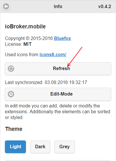

Go to mobile page, press on "Info" (top, right) and press "Refresh" to load objects from ioBroker Slider

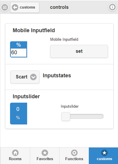

After reload you can go to "Customs => controls" Slider

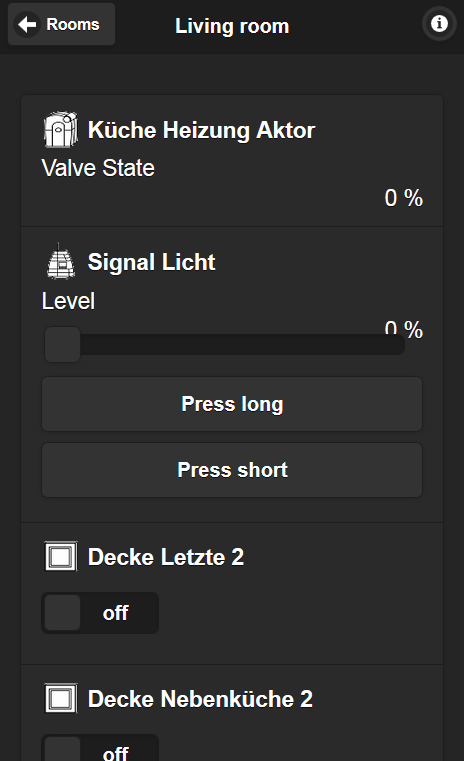

Sliders:
Slider
- role = "level.dimmer"
- role = "level.blind"
- role consists "level", common.type is "number", common.write is "true" and common.max is defined
- common.type = "number", common.write is "true" and common.max is defined
