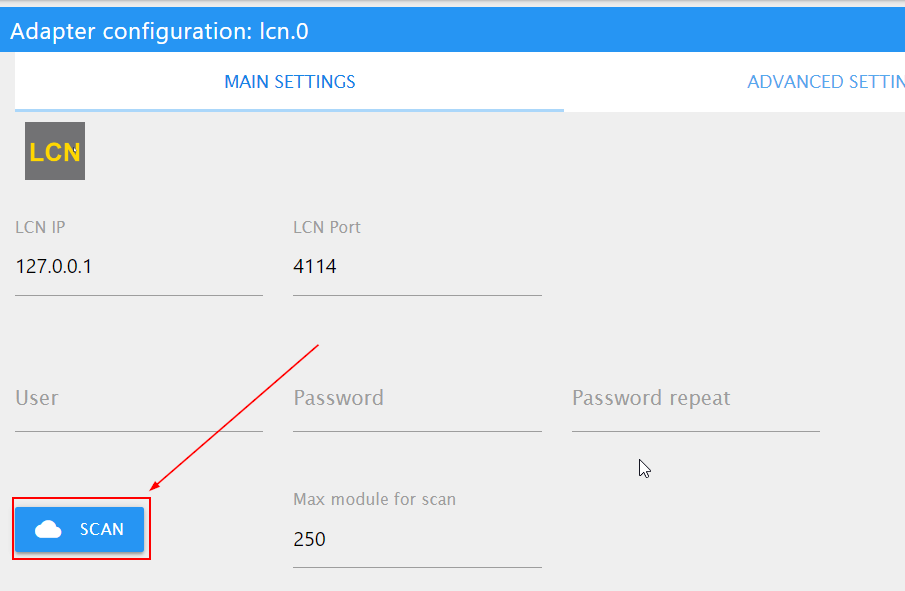

How to use
After the first start, the devices must be scanned. It can be done in the configuration dialog with scan button
scan
