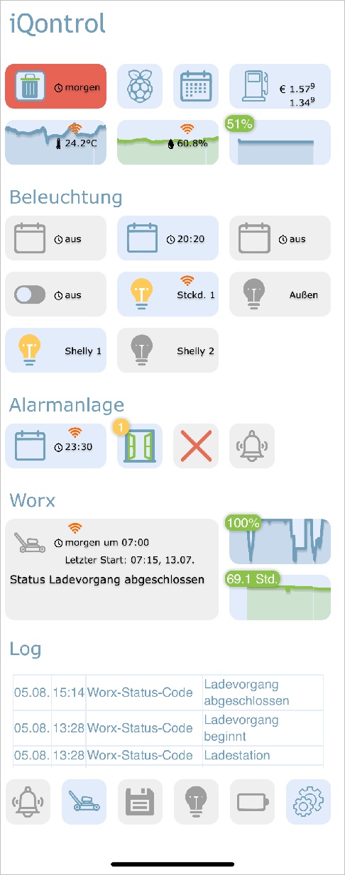

iQontrol adapter for ioBroker
Fast Web-App for Visualization.

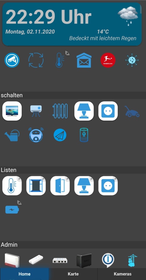

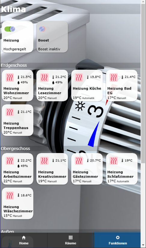

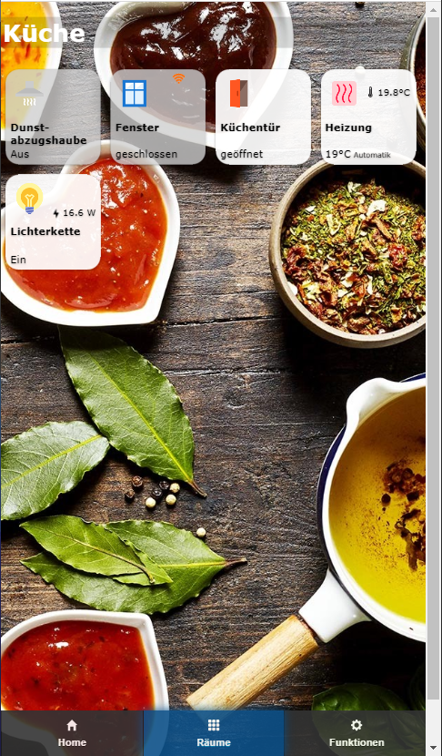

© by dslraser:
© by dslraser
© by muuulle:
© by muuulle
© by peks-64:
© by peks-67
Runs in any Browser. Easy to set up, although it's fully customizable and responsive.

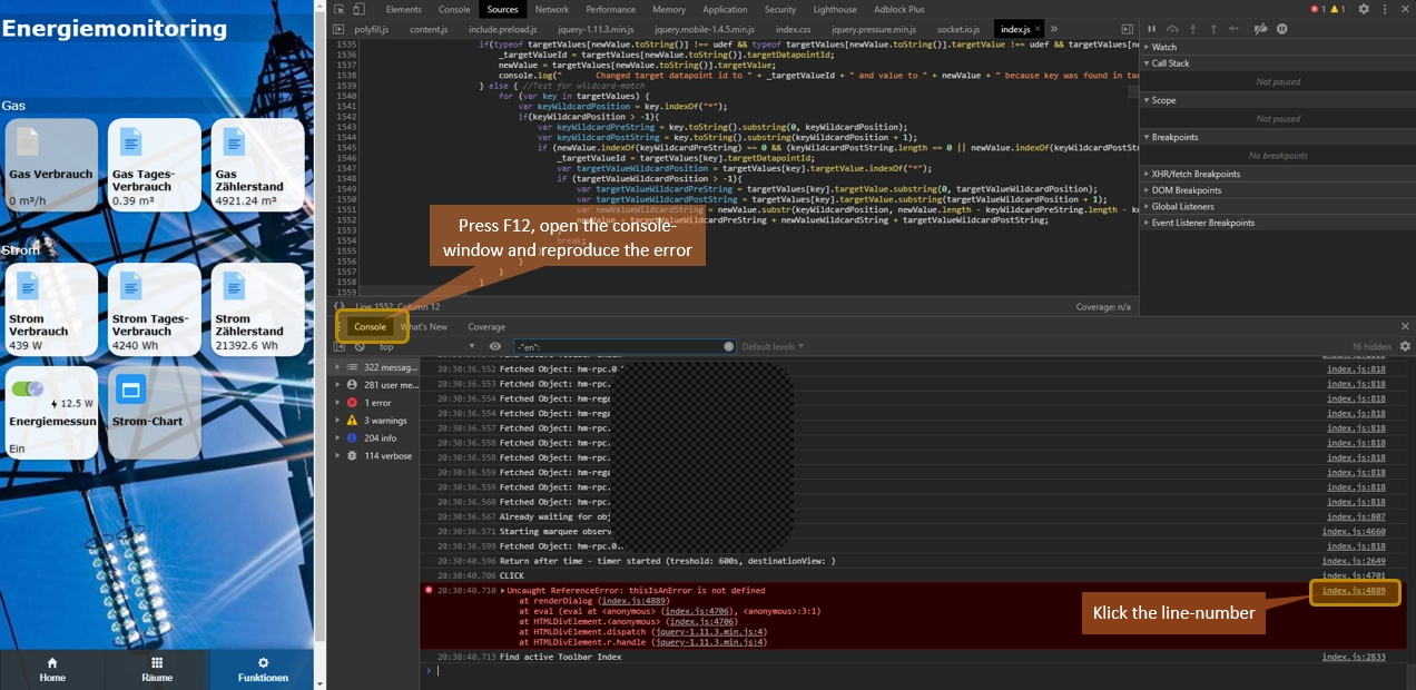

How to report issues and feature requests
Ideally, please use GitHub issues for this, with the best method achieved by setting the adapter to Debug log mode (Instances -> Expert mode -> Column Log level). Then retrieve the logfile from disk via the 'log' ioBroker subdirectory, not from Admin, which will cut lines.

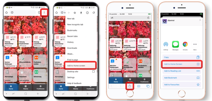

Add to Homescreen
You can save it as Web-App on Homescreen, and it looks and feels like a native app: Add to Homescreeen
This also works on your PC with Chrome:
  • Open iQontrol in Chrome
  • Klick on the three-dots-menu - More tools - Create shortcut
  • You will then find iQontrol in the start menu under chrome apps and can even add it to your taskbar

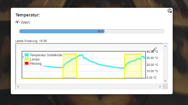

Charts
  • You can add the ''FLOT Chart-Widget'' as BACKGROUND_URL of any device, which will automatically display the main state as a chart in the background of the device-tile
  • You need to ensure that the state is logged and recorded by one of the history-adapters of ioBroker
Chart

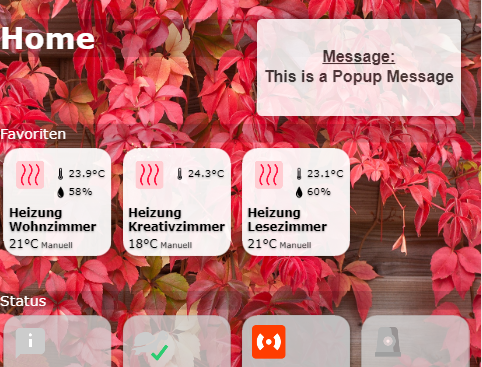

Popup-Messages
  • Every instance creates the state iqontrol.x.Popup.Message
    • When passing values to this state, a popup-message (or toast) will be displayed on all currently opened iQontrol frontends
  • Additionally every instance creates the state iqontrol.x.Popup.PersistentMessage
    • When passing values this state, the popup-message will be saved into the PERSISTENT_MESSAGES_PENDING-Array.
    • Persistent messages will not be only displayed on all currently opened iQontrol frontends, but also on all in future opened instances until they are confimed (by click or duration) or they expire.
    • PersistentExpires defines, when the persistent message expires as a UNIX-Timestamp (seconds from 1970-01-01 00:00:00). Values lower than 31536000 are interpreted as a duration in seconds from now (31536000 seconds = 1 year).
    • PersistentUndismissible boolean - If this is set to true, the persistent message will be kept even after it is closed. If you open a new iQontrol instance, it will be displayed again. Otherwise persistent messages are deleted after the popup closes (even by click or when the duration has elapsed).
    • PersistentId is an optional arbitrary expression that can be used to identify the message.
      • The id can be used to delete corresponding popup messages by sending the id to PERSISTENT_MESSAGES_DELETE_ID. Sending null to this datapoint removes all pending messages.
      • The id can also be used to display corresponding popup messages on all currently opened iQontrol-Instances again by sending the id to PERSISTENT_MESSAGES_SHOW_ID. Sending null to this datapoint shows all pending messages.
    • Note: You can send a message to only one of the two data points "Message" or "PersistentMessage", not to both.
  • You can use html-tags to format the message text
  • There are some additional states for further customization of the displayed popup (these must be set, before the message datapoint is set):
    • Duration: This is the time in ms the message is displayed; if set to 0 the message has to be confirmed
    • ClickedValue and ClickedDestinationState: If the popup is clicked by user, the value from ClickedValue will be sent to iqontrol.x.Popup.POPUP_CLICKED and, if specified, additional to the datapoint in ClickedDestinationState
      • If no value is specified, true will be used
    • ClickKeepsOpen boolean - if true, the popup can only be closed by clicking on a button, klicking the popup itself will not close it. So make shure you add buttons to your popup-message, as described beneath.
    • ButtonNames: Here you can specify a comma separated list of buttons, that will be displayed at the bottom of the popup (for example "OK,Abort")
      • ButtonValues and ButtonDestinationStates: These are comma separated lists of values that will be sent to iqontrol.x.Popup.BUTTON_CLICKED and, if specified, additional to the datapoint in ButtonDestinationStates, if the user clickes the corresponding button
        • Instead of a datapoint you can use the commands COMMAND:renderView and COMMAND:openDialog as a ButtonDestinationState, to render a view or open a dialog
        • The ButtonValue then specifies the view resp. dialog and needs to be in the format iqontrol.<instance-number>.Views.<view-name> resp. iqontrol.<instance-number>.Views.<view-name>.devices.<device-number> where <device-number> starts from 0 (so the first device on a view is device number 0)
      • If you only use one value (instead of a comma separated list), this value will be used for all buttons
      • If you leave ButtonValues empty, the name of the button will be used
      • If you only use one destination state (instead of a comma separated list), this state will be used for all buttons
      • ButtonCloses: This is a comma separated list of booleans (true/false) that specify, if the popup should be closed, when the corresponding button is pressed
      • ButtonClears: This is a comma separated list of booleans (true/false) that specify, if the popup settings should be cleared (= set all popup-states to empty), when the corresponding button is pressed

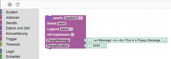

  • Alternatively you can set these values via sendTo-command with the parameters PopupMessage, PopupDuration, PopupClickedValue and so on
    • Example: sendTo("iqontrol", "send", {PopupMessage: 'This is my message', PopupDuration: 2500, PopupClickedValue: 'messageConfirmed'});
  • You can also use blockly to send messages to iQontrol
Popup Screenshot Popup Blockly

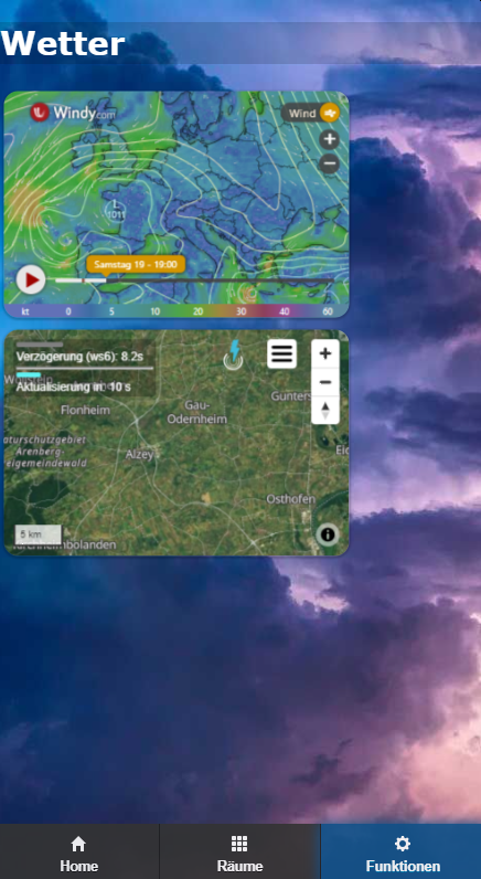

Widgets
  • Every tile has a BACKGROUND_URL and a BACKGROUND_HTML datapoint
  • Here you can define a link (via BACKGROUND_URL) to a website or place direct HTML-Code (via BACKGROUND_HTML), that will be displayed as background of the tile
  • This gives you the possibility to place (interactive) content inside a tile (like clocks, FLOT-charts, tables, weather-forecasts and so on)
  • By default, mouse events will be directed to this content (thus you can't click the tile itself anymore), but you can disable this with the option "Direct mouse events to the tile instead to the content of BACKGROUND_VIEW/URL/HTML"
  • iQontrol offers a device-role "Widget" which has some predefined options set that will be mostly used when showing a website as widget. But you can achieve the same result with any other role by modifying the devices options properly.
Popup Screenshot

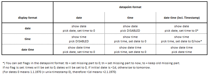

    • timeCaption (Caption for TIME) - only valid for role DateAndTime:
      • Default: ""
    • timeFormat (Format of TIME (as stored in the datapoint, see readme)) - only valid for role DateAndTime:
      • Default: "x"
    • timeDisplayFormat (Display-Format of TIME (how it should be displayed, see readme)) - only valid for role DateAndTime:
      • Default: "dddd, DD.MM.YYYY HH:mm:ss"
    • timeDisplayDontShowDistance (Show Distance) - only valid for role DateAndTime:
      • Possible values: ""|false|true
      • Default: "" (this means, use custom datapoint settings)

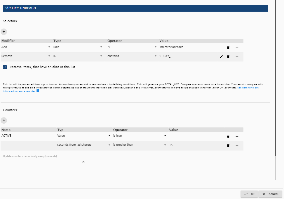

  • This example shows, how to create an UNREACH-List: List Edit Unreach
    • The selectors first add all Data points with the common role indicator.unreach
    • But it then removes all Data points with STICKY_ in its ID (homematic provides the STICKY_UNREACH-Indicator, which we don't want to count)
    • It filters duplicates by aliases out List Edit Unreach

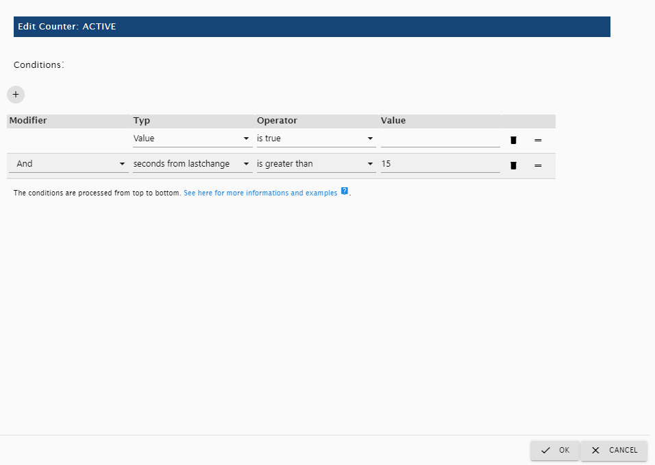

    • And lastly, it counts all data points with the value true, that have that state for at least 15 seconds

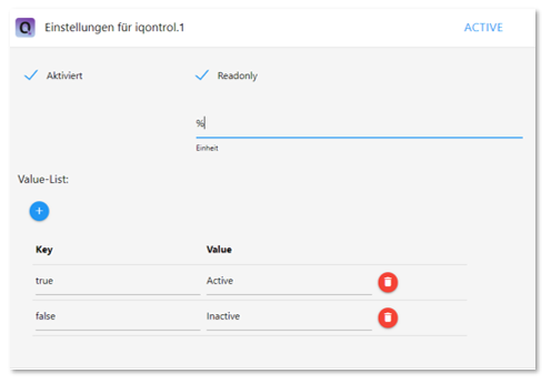

You can modify the configuration of data points via the wrench-icon (or rather gear-icon in new react-ui) behind a datapoint in the device-configuration dialog or in objects-tab of iobroker.
CustomDialog Call CustomDialog Example
Here you can:
  • Set Readonly-Flag
  • Set Invert-Flag
  • Set Confirm-Flag (forces the user to confirm before a change is written to a datapoint)
  • Set PIN-Code (forces the user to enter this PIN-Code before a change is written to a datapoint - but take care: this is only of low security, because the pin is checked in frontend! Use a number to display a fullscreen-pin-pad if asked for code)
  • Modify unit of datapoint, separate for zero, singular and plural values
  • Modify min and max of datapoint
  • Set the steps that a level-slider takes when it is increased/decreased
  • Modify type of datapoint
  • Modify role of datapoint

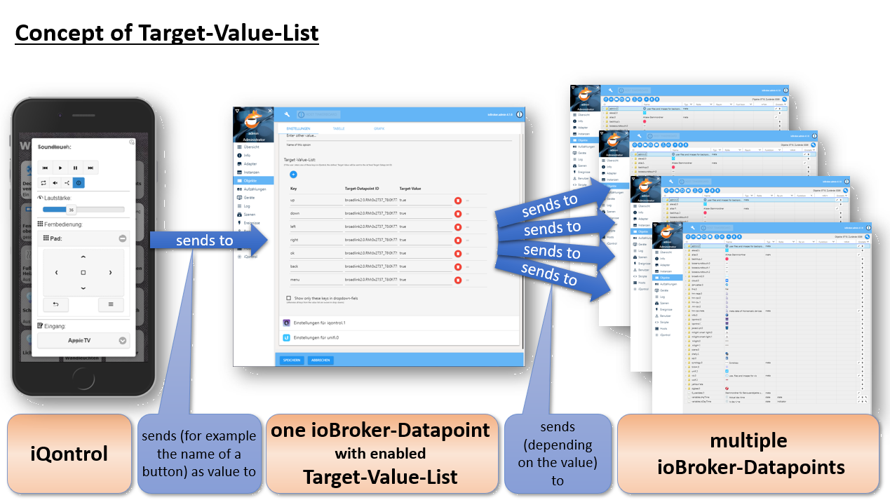

  • Set a target-value-id, which is a datapoint id, where target values are written to (if you have different data points for the actual and the target value)
  • Set or modify a Value-List
    • Add optionally an option to value list to enter free text
  • Set a target-value-list:
    • In addition to the target-value-id, you can define different datapoint-ids and target-values for different keys (keys are possible values of the original datapoint)
    • You can also use the wildcard * in the keys and in the target-values
    • Example:
      • Key: TuneIn-Playlist: *, Target-Datapoint ID: alexa2.0.Echo-Devices.XYZ.Music-Provider.TuneIn-Playlist, Target-Value: *
      • If the user enters TuneIn-Playlist: Ambient the value Ambient will be written to alexa2.0.Echo-Devices.XYZ.Music-Provider.TuneIn-Playlist Concept of Target-Value-List

  • value-list - the selected value will be displayed. If it is not write-protected it will generate a drop-down-menu in dialog
    • Technically a value-list is a value with a corresponding translation-list, defined in the common.custom.iqontrol.<instance>.states, native.states or common.states object of the datapoint:
      "native": {
          "states": {`true`: "Text for true", `false`: "Text for false"},
    • You can create your own value list by modifying the datapoint (wrench-icon, or rather gear-icon in new react-ui, behind the datapoint in the objects-tab of iobroker, see above)
    • iQontrol will display a defined valueList as a drop-down field in the dialog under the following circumstances:
      • if type is number and the valueList has exact as many entries, as steps between min- and max of the datapoint or
      • if type is boolean, but role is not switch or
      • if type is string or
      • if "Add option to enter free text" is activated

Thermostat:
  • SET_TEMPERATURE: number - goal-temperature
  • TEMPERATURE: number - actual temperature to be displayed in small in the upper right corner
  • HUMIDITY: number - actual humidity to be displayed in small in the upper right corner
  • CONTROL_MODE: value-list - display and set the mode of the thermostat
  • WINDOW_OPENING_REPORTING: boolean - if true, a little opened window is displayed
  • VALVE_STATES: array of names and numbers - displays the opening of the valves that are associated with the thermostat
Homematic-Thermostat:
In addition to normal thermostat you can define:
  • PARTY_TEMPERATURE: string - special-formatted string to define the party- or holiday-mode of Homematic-thermostats
  • BOOST_STATE: number - displays the remaining boost-time of Homematic-thermostats

  • TIME: string - String with date and or time or duration (you can specify the format in the device options) for first and second time
Show possible time formats: (klick to open)
  • In the custom-section (wrench-icon or rather gear-icon in new react-ui) of any datapoint you can configure time-format and time-display-format. If the datapoint contains time information, these two parameters specify in which format the time is saved in the datapoint and how iQontrols displays the time to the user.
  • For the 'Date and Time'-Device these two settings can also be made in the device options inside the device-specific section. These will overwrite the settings made in the custom-section of the datapoint.

FlagsSet missing parts to beginningtbE.g. set date to 1970-01-01, if only a time is givenX------
Set missing parts to nowtnE.g. set date to now, if only a time is givenX------
Keep old missing partstoE.g. leave date as before, if only a time is givenX------
Free textMark free text in brackets[][this is an example, all tokens are ignored]XX---
  • If you use different configurations for datapoint-timeformat and display-timeformat, the following conversion-rules are used.
  • You can use the flags tb, tn and to inside the datapoint-timeformat to influence the behavior.

    • Keep in mind: You can use the Target-Value-List (accessible via the wrench-icon, or rather gear-icon in new react ui, of each datapoint) to link from one datapoint to multiple data points, depending on the returned value (see Modifying Datapoints section above)

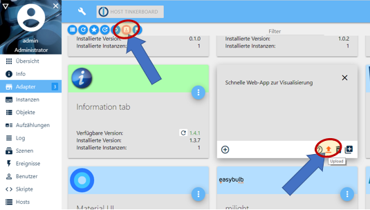

Troubleshooting
  • Make sure you fulfilled the 'You need...' section at top of this page
  • If something doesn't work like expected after update please try the following steps:
    • Start upload of adapter:
      Upload
    • Clear browser cache
    • Restart ioBroker

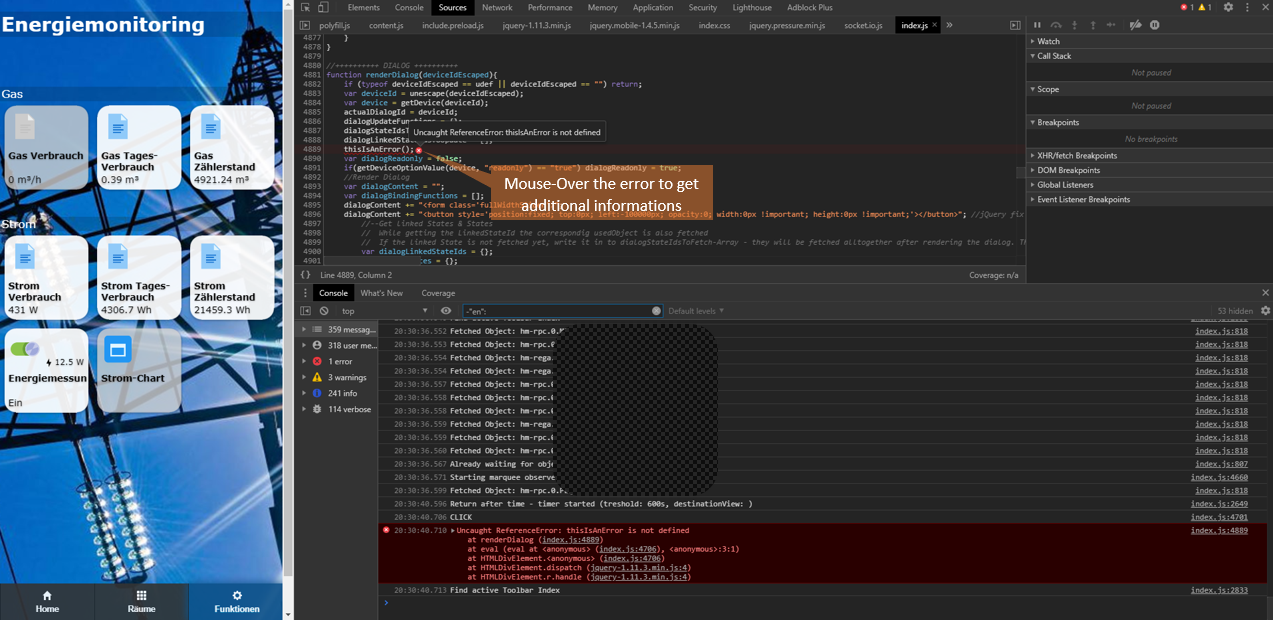

If you have further problems, please provide the log from the debugging-console of your browser and screenshots of the faulty line:
  • Start iQontrol with opened debugging-console of your browser (mostly you need to press F12 to open it)
  • Switch to the console-window and reproduce the bug
  • Look for messages in the console-window
  • When errors appear, the number of the line, which caused the error, is listed
  • Please click on this line-number and make a screenshot of the faulty line:
Troubleshooting console window Troubleshooting faulty line
