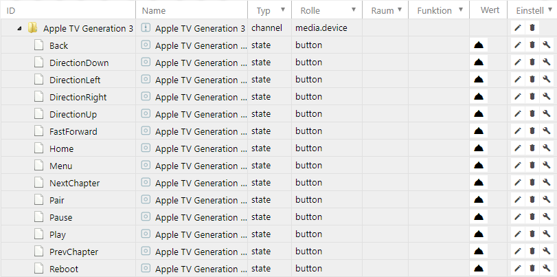

Device functions
If a device is opened, a list with all functions belonging to that device is shown. These device functions are device-specific and therefore differ between devices of different types.
Device
Triggering a device function
Every device function {instance}.{hub name}.{device}.{device function} triggers the corresponding reaction of the addressed device. The values of device functions can be read and written. The triggering can be tested by clicking the bell to the right of the function with the mouse pointer. Alternatively a value can be entered there with the pencil symbol.
Values have the unit milliseconds. If a value between 1 and 250 ms is entered, the Harmony hub usually sends a single key press of the given length. Values greater than 250 ms can lead to the device function being triggered several times.
After the device function has been triggered, the value changes back to 0.

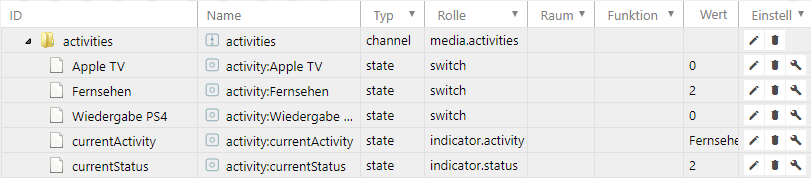

Activities
All activities programmed at the Harmony hub are listed below activities.
Activities
Starting an activity
An activity is started by entering a number greater than 0 at the activity {instance}.{hub name}.activities.{activity}. While the activity is being executed, this value first changes to 1 (= starting) and then to 2 (= active).
Stopping an activity
Running activities are stopped by setting their value to 0. Alternatively, any number can be entered in the object {instance}.{hub name}.activities.currentStatus to stop the running activity. While the activity is being stopped, {instance}.{hub name}.activities.currentStatus changes from 3 (= stopping) to 0 (= inactive).
Further status values
{instance}.{hub name}.activities.currentActivity returns the currently running activity as a string.
{instance}.{hub name}.activities.currentStatus shows the status of the Harmony hub. The values mean:
  • 0 = inactive
  • 1 = starting
  • 2 = active
  • 3 = stopping
{instance}.{hub name}.activities.{activity} shows the status of a single activity. The meaning of the values is the same as for {instance}.{hub name}.activities.currentStatus.

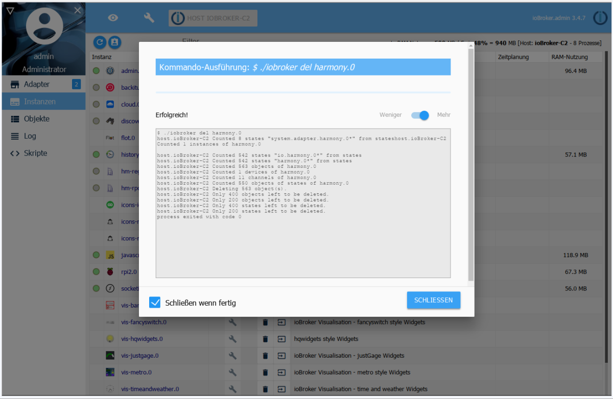

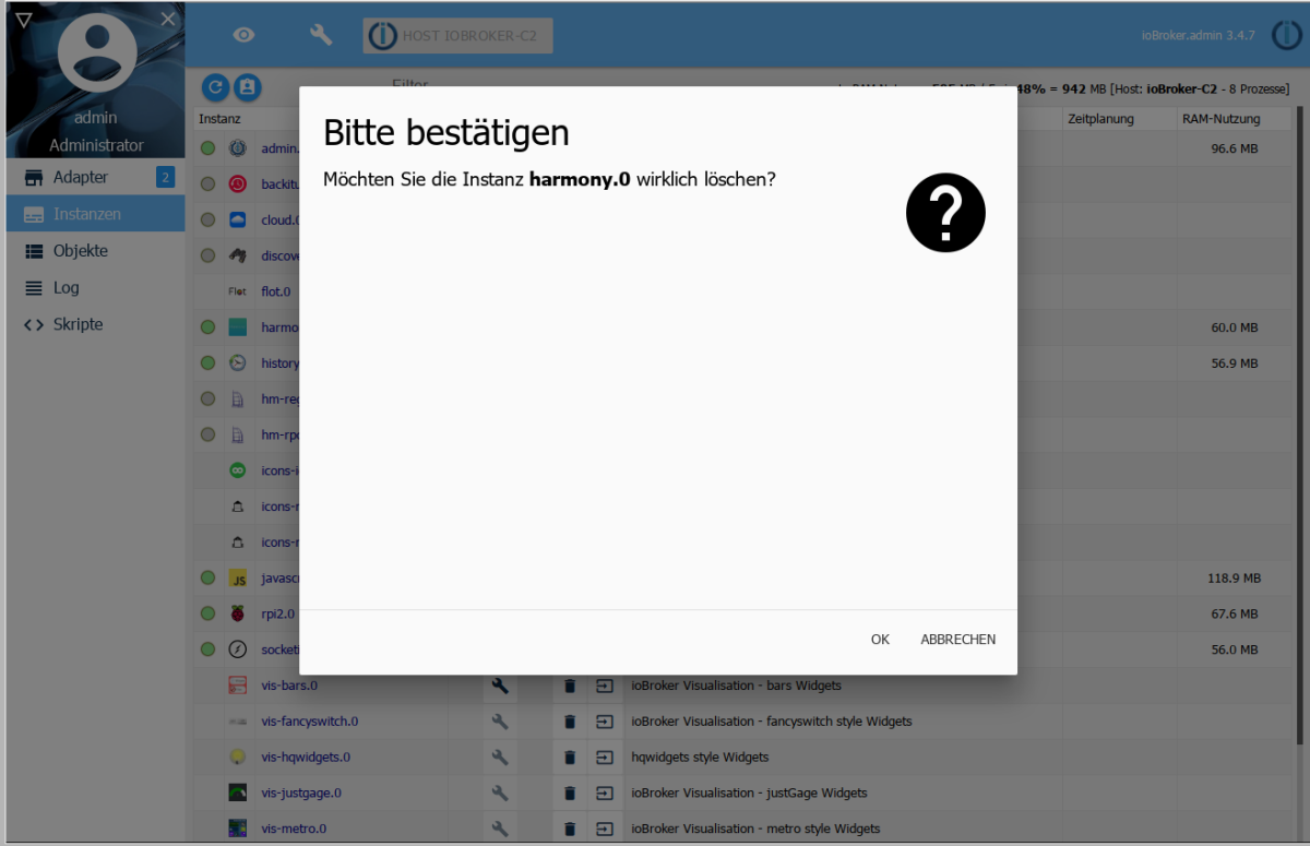

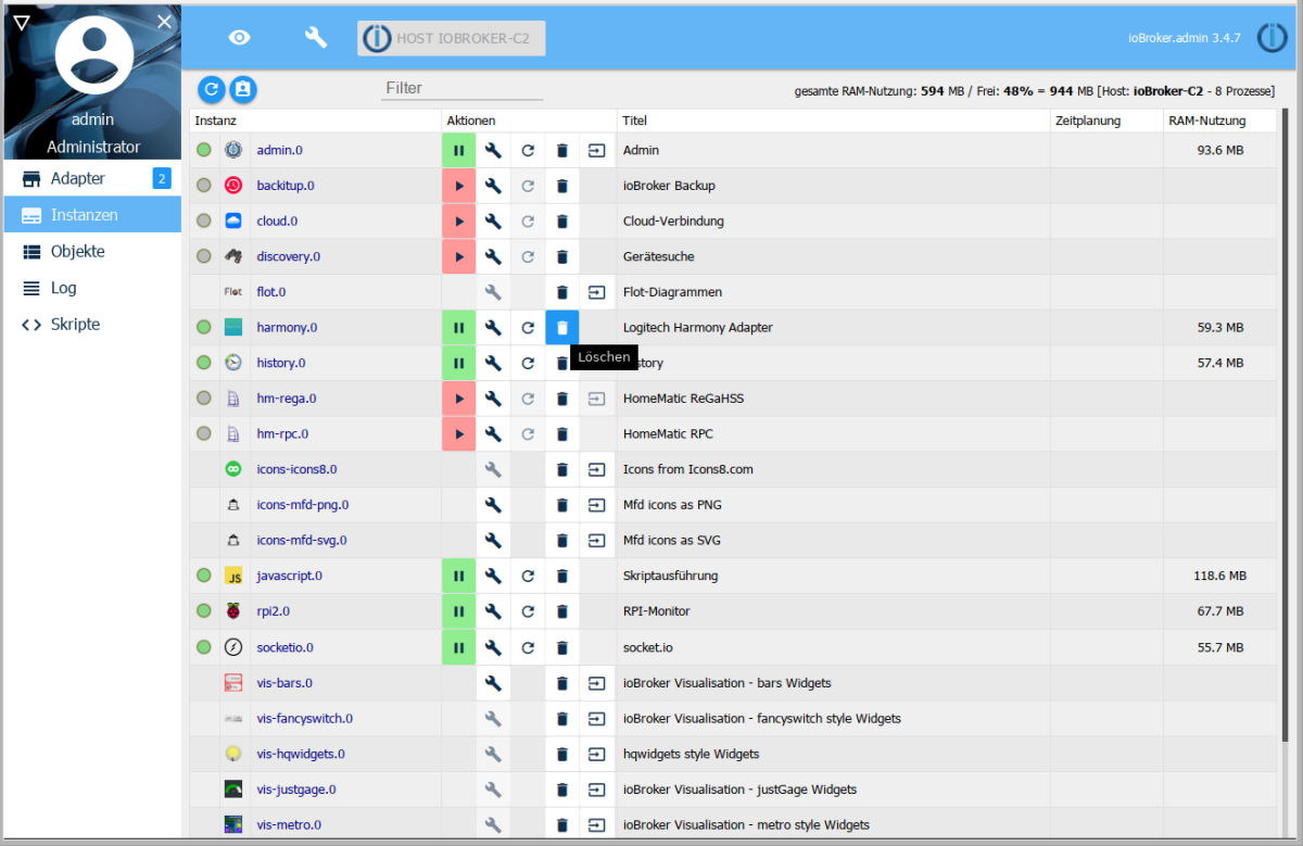

Uninstallation
If the instance is to be removed again, it is removed with the trash can icon assigned to it in the Instances section.
Delete
A confirmation prompt appears, which has to be confirmed with OK.
Delete2
Afterward a window appears again that shows how the uninstallation commands are processed.
Delete3
This uninstallation removes all objects belonging to the instance completely.

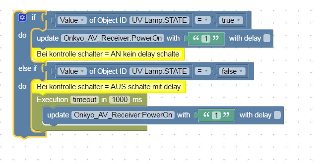

JavaScript
Triggering device functions. Here the Denon AV receiver is switched on or off when the value of another state changes.
if (getState("hm-rpc.0.MEQ01234567.2.STATE").val == true) {
  setState("harmony.0.Harmony Hub.Denon AV-Empfänger.PowerOn"/*Denon AV-Empfänger:PowerOn*/, '1', true);
  // control switch == ON: switch without delay
} else if (getState("hm-rpc.0.MEQ01234567.2.STATE").val == false) {
  // control switch == OFF: switch with a delay
  var timeout = setTimeout(function () {
  }, 1000);
Blockly
Blockly
