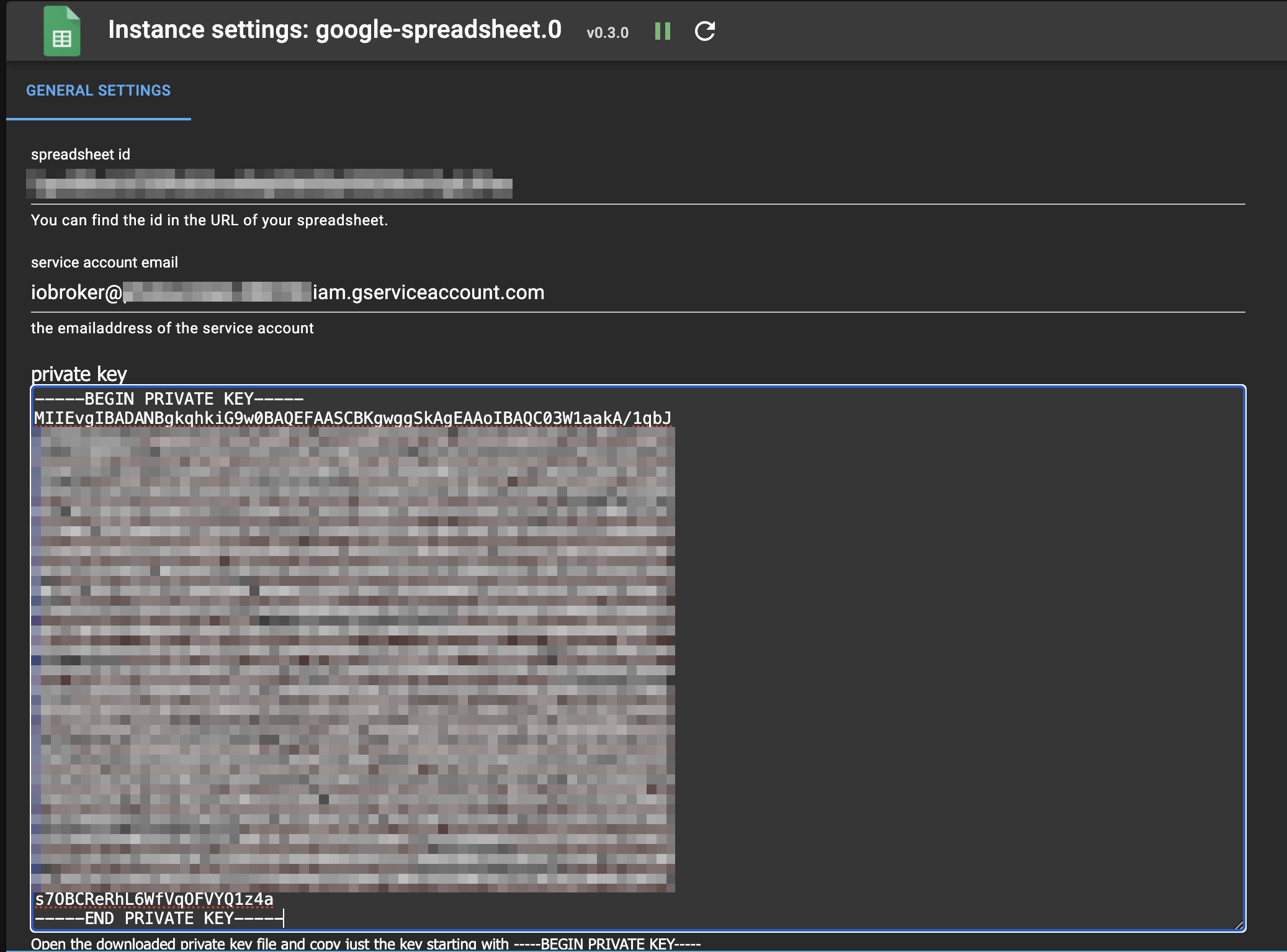

Configure the Adapter Instance
Add the following information to the configuration of your adapter instance in ioBroker:
  • Spreadsheet ID - You can find the ID in the URL of your spreadsheet.
  • Service Account - The email address of the service account you created.
  • Private Key - Open the downloaded JSON file, and locate the private key within the file. Copy only the part starting with "-----BEGIN PRIVATE KEY-----."

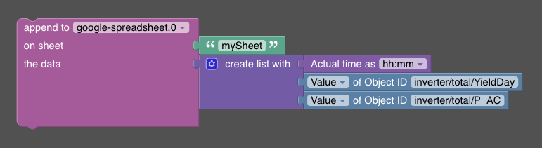

Blockly
Use the available blocks to automatically interact with your spreadsheet.
Blockly
Troubleshooting
Error while sending data to Google Sheets:Error: error:0909006C:PEM routines:get_name:no start line
When copying the private key into the configuration, make sure there are no \n. If there are \n in the key, please replace the with normal line breaks
Error while sending data to Google Sheets:Error: The caller does not have permission
Make sure the Service Account has adequate permissions to write to the spreadsheet. Refer to the "Grant Access to the Spreadsheet" section above.
