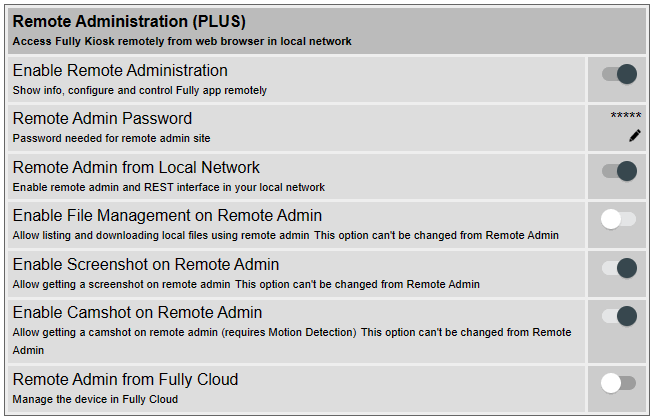

Fully-Browser settings
Activate Remote Admin
  1. On the tablet, open the Fully Browser app and open the Fully Browser settings.
  2. Open menu item Remote Administration (PLUS)
  3. Enable Enable Remote Administration
  4. Remote Admin Password: enter a password
  5. Enable Remote Admin from Local Network

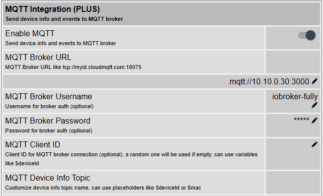

Activate MQTT
  1. On the tablet, open the Fully Browser app and open the Settings. Alternatively, you can also open the Remote Admin from another device (e.g. PC) from a browser, the URL is typically always http://ip-address:2323, you will be asked for the password assigned above.
  2. Open: Settings -> Other Settings -> MQTT Integration (PLUS)
  3. Enable Enable MQTT
  4. MQTT Broker URL: Enter in the format mqtt://iobroker-ip-address:3000, where iobroker-ip-address is the IP address of the ioBroker, and 3000 is the port number used for the MQTT connection.
  5. MQTT Broker Username: here you can optionally enter a username
  6. MQTT Broker Password: here you can optionally enter a password
  7. MQTT Client ID: can be left empty
  8. MQTT Device Info Topic: here you can leave the default setting, it will not be used by the adapter.
  9. MQTT Event Topic: here you can leave the default setting, it will not be used by the adapter.
