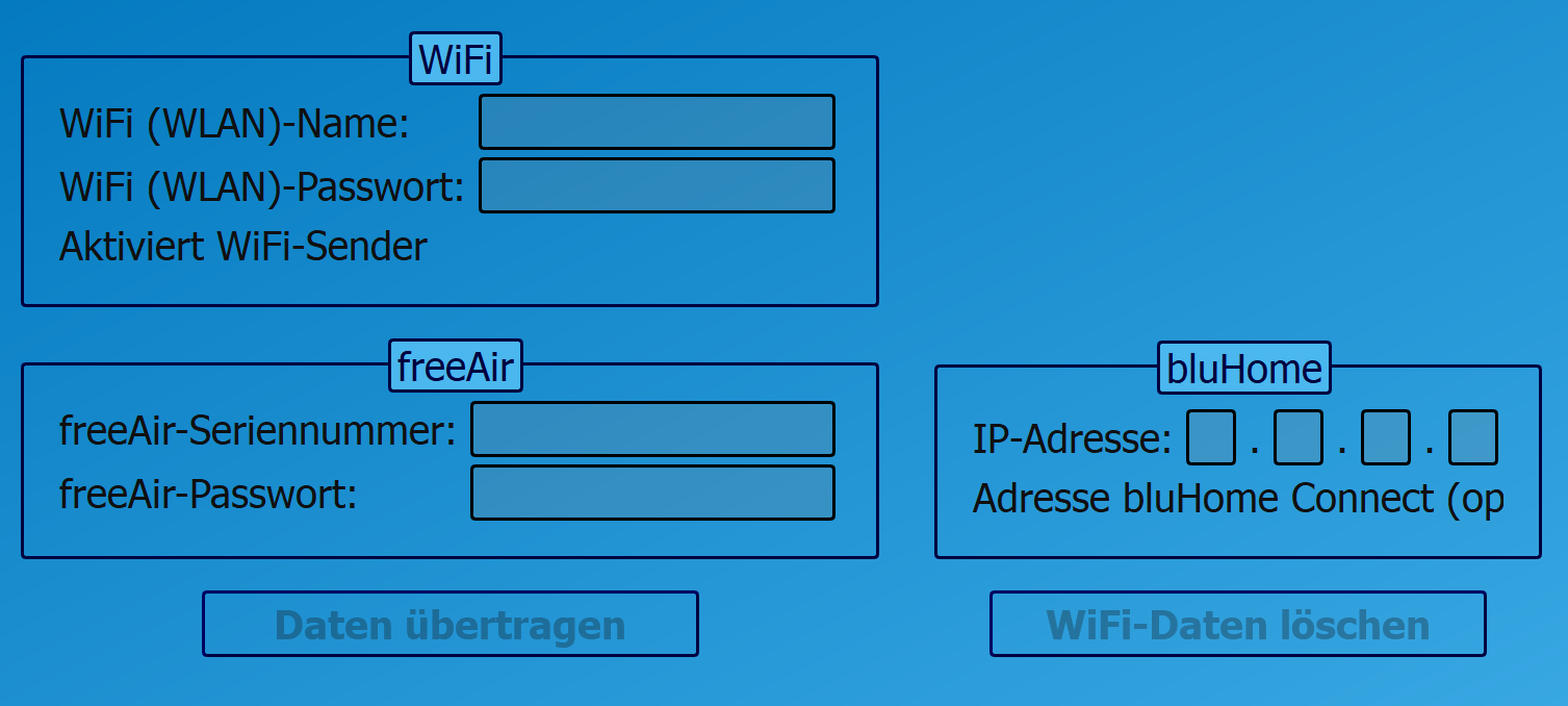

Settings
FreeAir 100
image info
  • under bluHome add the ip adresse of your ioBroker

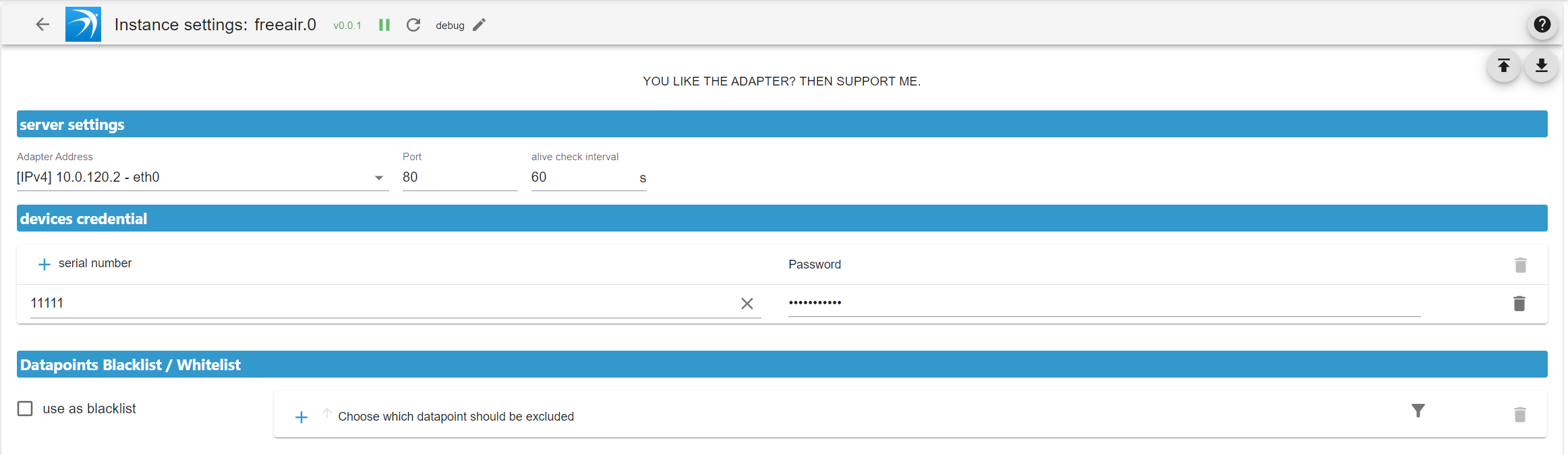

Adapter
image info
Server Settings
  • Adapter Adress: the ip adress of your ioBroker
  • Port: default port is 80, because the FreeAir 100 devices send it's data to port 80
    NOTE: you can change the port e.g. config a DNAT rule in your gateway
  • alive check interval: if in this interval no data received, devices will be shown as offline
devices credential
  • add the serial number of your FreeAir 100 devices
  • add the password, that you have set in your FreeAir 100 device
Datapoints Blacklist / Whitelist
  • blacklist or whitelist datapoints.
