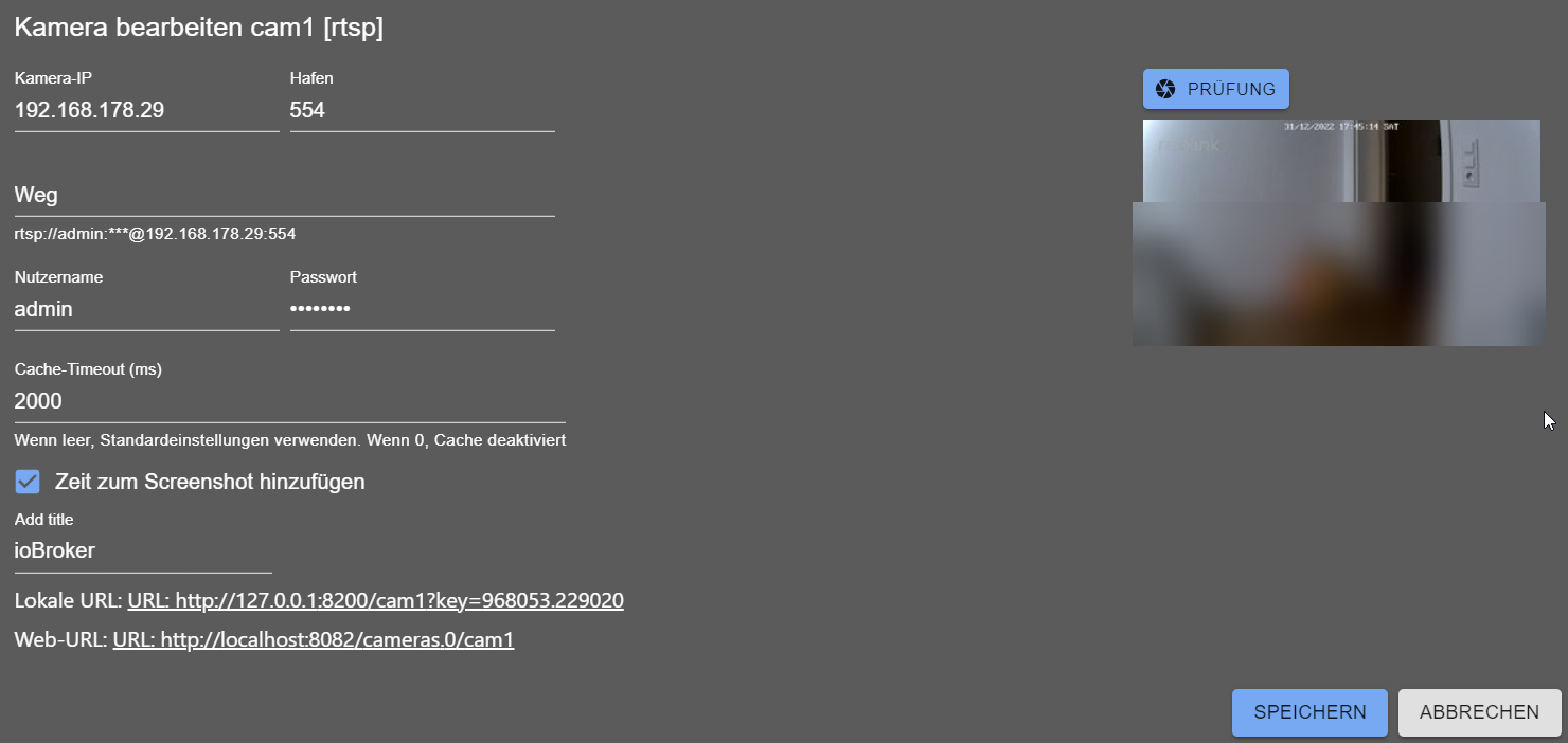

Here is an example of how to add Reolink E1:
rtsp
