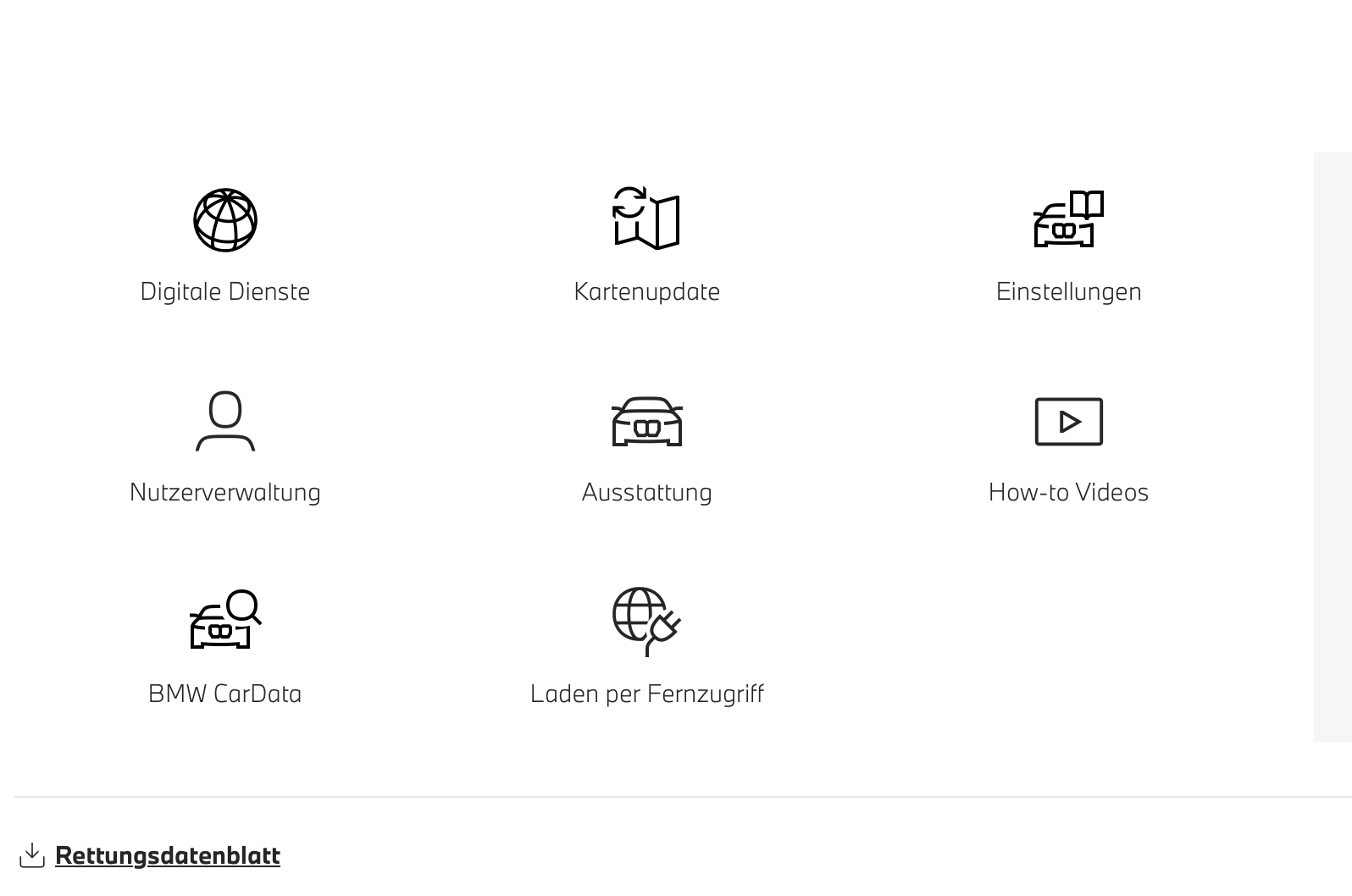

  1. Visit the BMW ConnectedDrive portal: https://www.bmw.de/de-de/mybmw/vehicle-overview or https://www.mini.de/de-de/mymini/vehicle-overview
  2. Navigate to the BMW CarData section (you'll see various service categories)
BMW Portal Overview

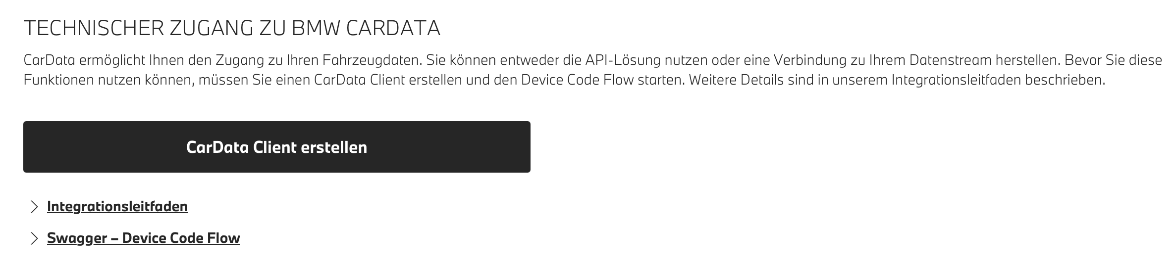

  1. Click on "CarData Client erstellen" (Create CarData Client) button
  2. Copy the client_id
  3. Wait 30 seconds
  4. Click on CarData API
  5. Wait 30 seconds
  6. Click CarData Streaming
CarData Client Setup
CRITICAL: Click one service and wait 30 seconds if you see an error message, then click again. Don't press on "Gerät Authentifizieren/Devict authentication" Enter the client_id in iobroker settings. If it is not working try all letters as lowercase.

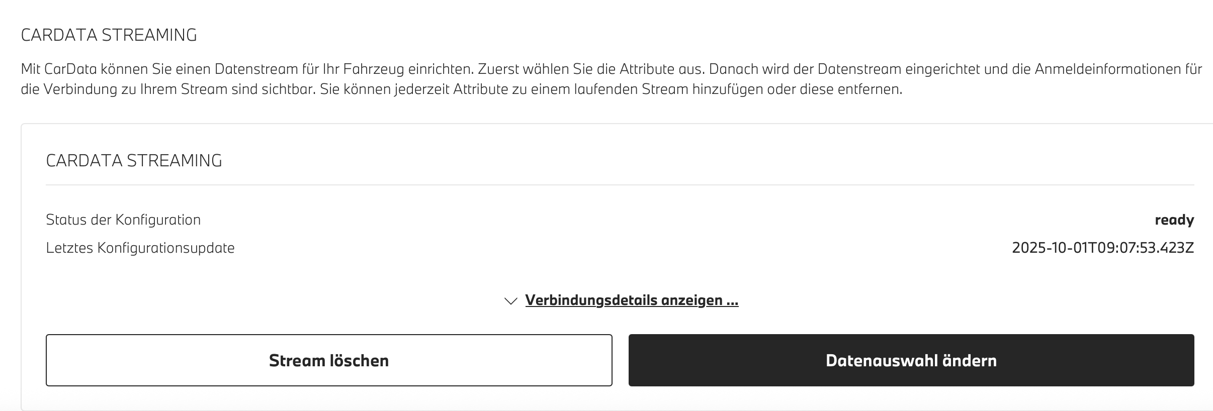

After creating your Client ID, configure streaming:
  1. In the CarData section, look for "CARDATA STREAMING"
  2. You should see the configuration status as "ready"
  3. Note the "Letztes Konfigurationsupdate" (Last Configuration Update) timestamp
CarData Streaming Setup
  1. Click "Datenauswahl ändern" (Change Data Selection) button
  2. Select ALL categories (Vehicle Status, Charging, Trip Data, etc.)
  3. Manually check ALL 244 individual data points
  4. Or enter this in Google Developer Console press F12 document.querySelectorAll('label.chakra-checkbox:not([data-checked])').forEach(l => l.click());
  5. Save your configuration by clicking "Stream löschen" if needed to reset, then reconfigure
Without selecting all data points, MQTT streaming will not provide complete data!
