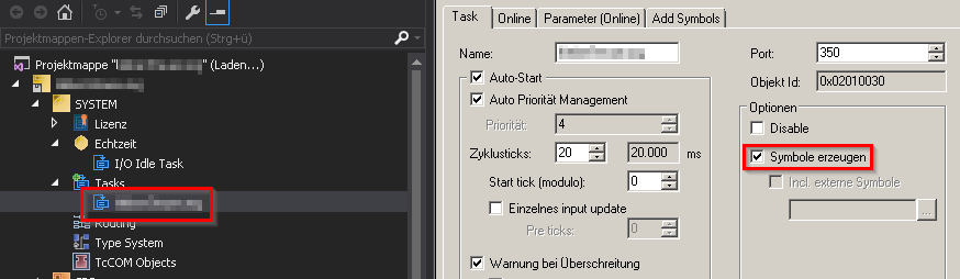

  1. Enable ADS on your PLC project. To do this click on your task and then enable the checkbox before Create symbols. Download the new configuration and make sure you reboot your PLC. The reboot is only needed when you are using TwinCat 2.
    createSymbols

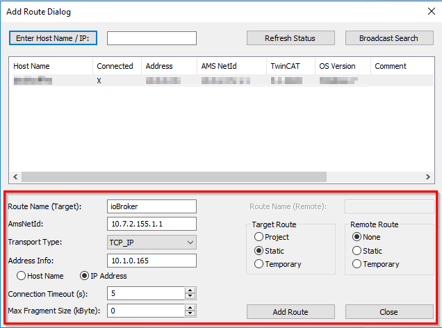

  2. Now add a static route to our Beckhoff PLC. The route should point to your server that will run the proxy application.
    Here an example to add a Static Route directly on PLC u can add this Route also from your EngineeringPC to the PLC.
    createSymbols
    Important is that the AmsNetId and the AdressInfo (IP-Adress) matches with the Adapter Settings. For further Information about TwinCat Router and Security read Documentation on Synchronisierung Beckhoff Information System
