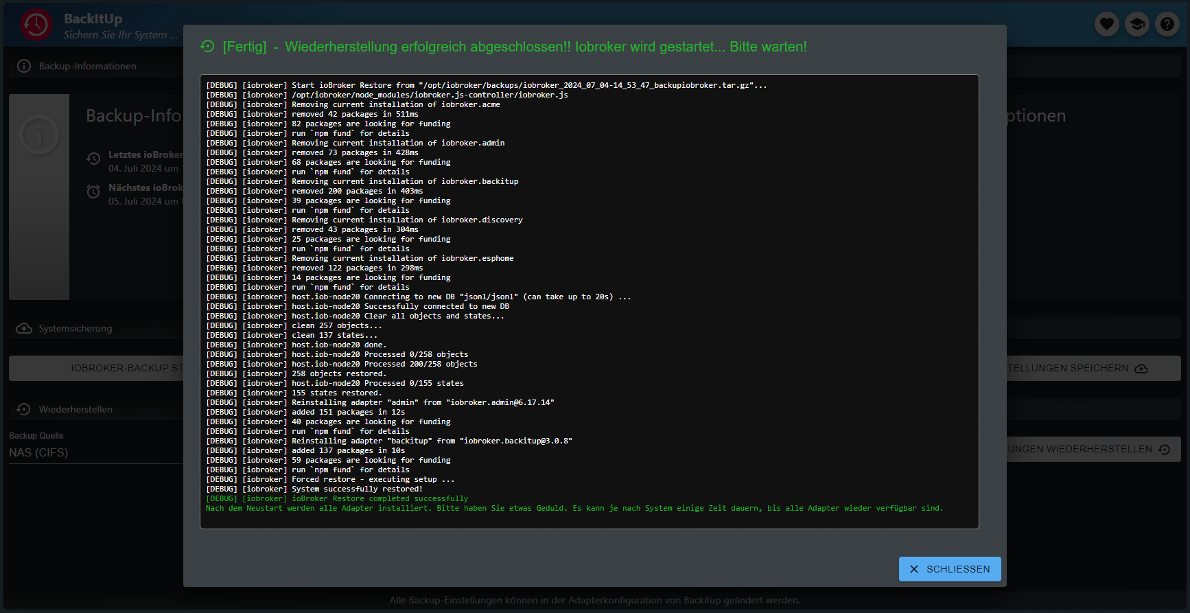

The restore is also completely identical to the CLI command iobroker restore <backupname> of the js-controller.
With a restore, all states, objects and user data are restored by Backup. After the restore, your ioBroker restarts and from there the js-controller takes over the installation of missing adapters again.
ioBroker.backitup has no effect whatsoever on the recovery after the ioBroker has started. This all happens in the background, and the js-controller takes over based on the restored information in the States and Objects.

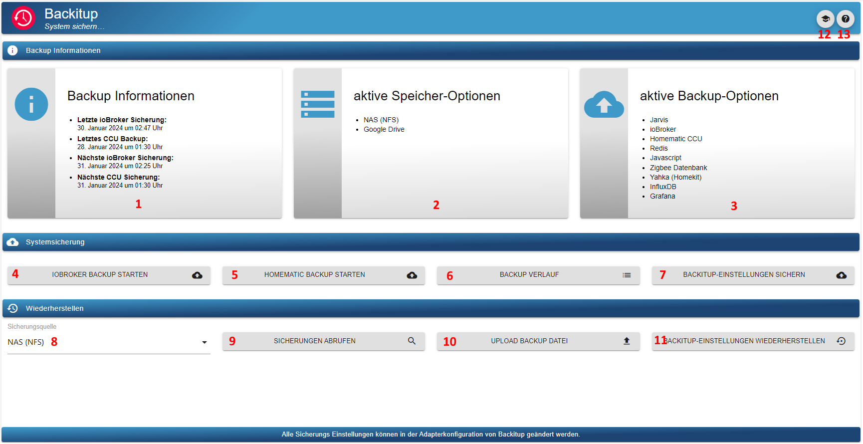

ioBroker.backitup can be configured in the adapter instances. All the following setting options are available there.
A tab is available in the admin tab for the daily work and operation of ioBroker.backitup.
If this tab is active in the tab menu of the admin interface, ioBroker.backitup can be operated directly via the tab in the left tab bar of the ioBroker.
Information on the backups made is available there, backups can be made and the backup can be restored.
adminTab
Here is a brief explanation of the options in the Menu tab
No.Description
1.Information on the last and next backup.
2.Information on where the backups are stored.
3.Information on which backup types are active and being backed up.
4.Start an ioBroker backup manually.
5.Start a Homematic backup manually.

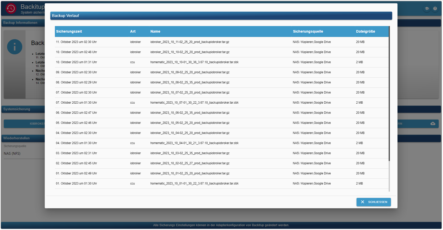

6.Opens a new window and displays all backups from the history.
7.With this button you can save the settings of ioBroker.backitup. This is a useful tool when changing systems. The settings are output in JSON format.
8.This option is used to select the memory from which the restore is to be executed.
9.With the "Retrieve backups" button, a new window opens and lists all existing backups in the selected memory.
10.If you want to restore a backup from another system, the backup file can be uploaded to the system using this button.
11.This button is used to restore the saved ioBroker.backitup settings within the adapter. It is not a restore of the ioBroker and only files in JSON format can be uploaded here!
12.Opens a new tab and shows the documentation of ioBroker.backitup.
13.Opens a new tab and shows the readme of ioBroker.backitup.

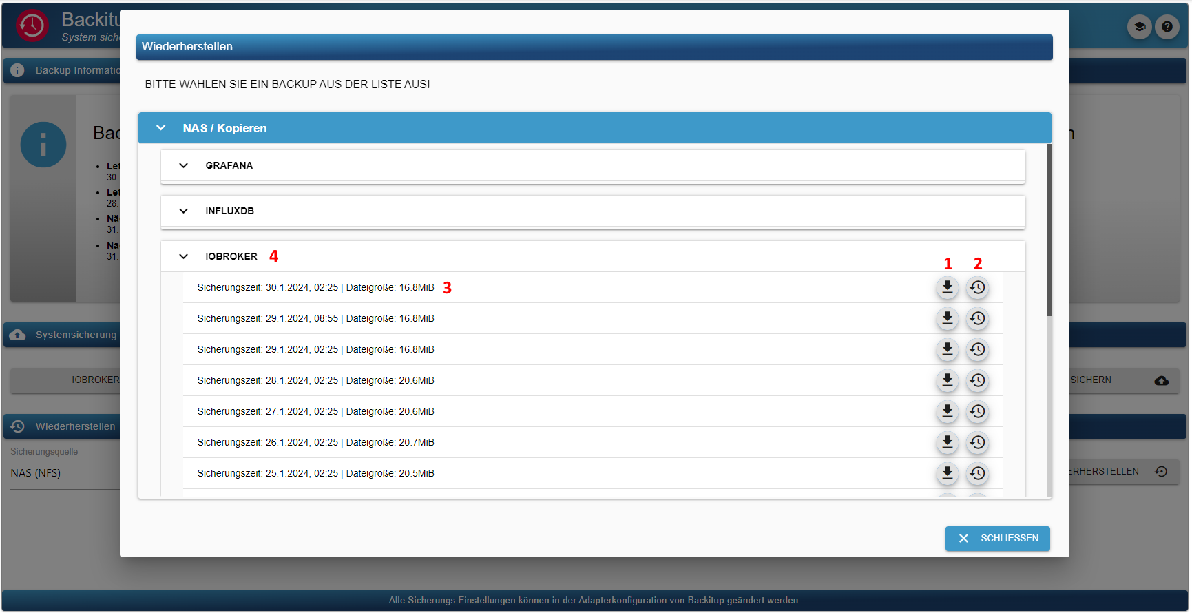

adminTabRestore
The operation of the Restore tab is as follows.
No.Description
1.Download the selected backup to the PC.
2.Start the restore of the selected backup.
3.Information about the backup.
4.Information about the backup type.

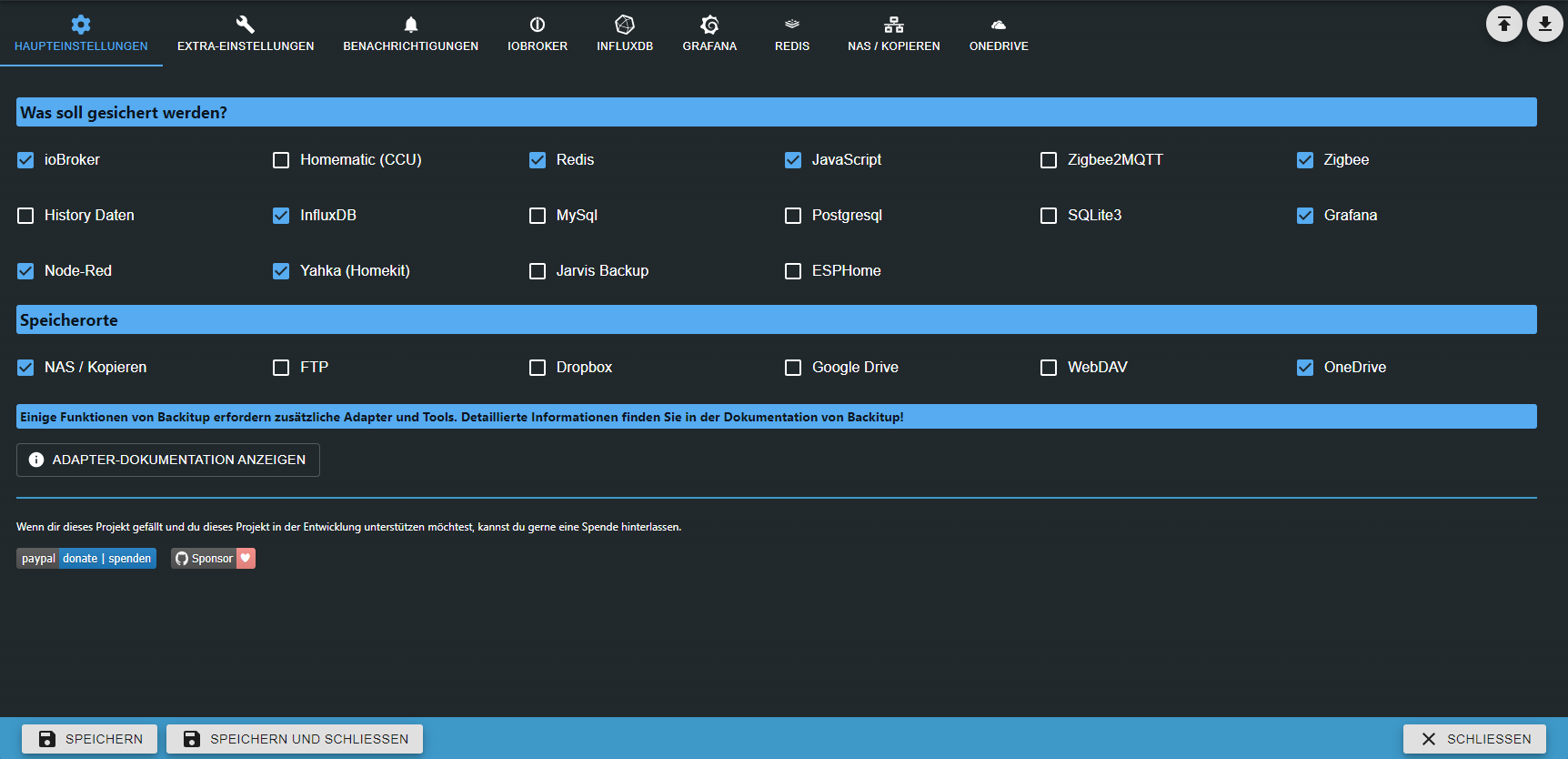

backitupConfig
Backup types
ioBroker.backitup offers a lot of possibilities to carry out different backup types cyclically or at the push of a button. By default, every backup is stored in the /opt/iobroker/backups/ directory. Optionally, an FTP upload can be set up or, alternatively, a CIFS / NFS mount can be used.

Restore
With ioBroker.backitup it is possible to restore all backup types created via the configuration menu in the ioBroker.
ioBroker.backitup works very closely with the js-controller and creates an ioBroker backup identical to the CLI command iobroker backup.
All states and objects as well as the user files such as VIS are backed up here identically to the standard backup of the js-controller.
adminByRestore
adminAfterRestore
A restore can be carried out from all storage media.
[!NOTE] Basically, however, the safest way is to execute the restore locally.
If you choose the safest way and want to do the restore locally, you have to store the backup file in the ioBroker backup folder. On Linux systems this folder is located under the following path: /opt/iobroker/backups
With the backup types "ioBroker" and "redis", the ioBroker is stopped during the restore and then restarted automatically.
ioBroker is not stopped with all other backup types. Here only the affected adapters are temporarily stopped.
